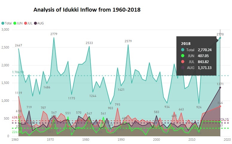

If we study the data of Idukki reservoir for the past few years we can understand what happened during flood 2018.
For Eg: what is the average inflow of water in to Idukki reservoir during various months of monsoon (The dotted lines)?
Analysis:
This is been shown in the picture 1 and it is For June - 226MCM, July- 438MCM, August - 376MCM. Now if we compare these values with inflow received in 2018, the results will give us what happened during flood???

In which year we have received the maximum inflow for August month?
Analysis:
We can see during 2018 we have received maximum inflow in the august month. So the graphical representation will always help us to have a clear picture on various issues.

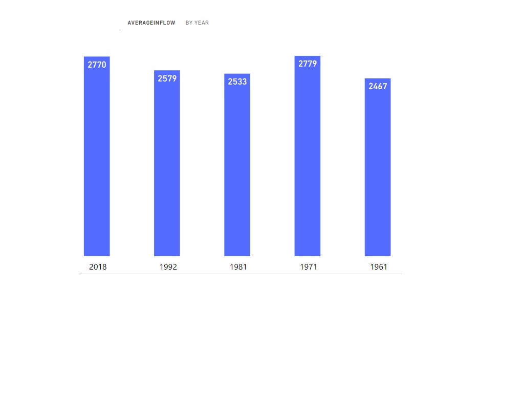

Heaviest Inflow
Now the average inflow in to idukki for the period of 1960 to 2019(Data up to September) is calculated and drilled down to see the top few years.(Picture 2)
Picture(2)
Analysis:
It is seen that strong inflow (2500MCM and above) in to the dam used to occur in a period of 10 years between 1933 and 1943 and 1961,1971 and 1981 etc.

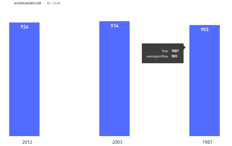

Moreover the worst inflow in to idukki reservoir happened in the year 2012,2003 and 1987(around 900 MCM) as shown below.
Picture (3)

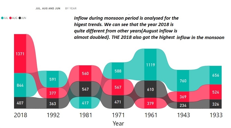

Considering these aspects we will go back to our previous analysis- ‘What happened in 2018?’. So I have taken a new graph which is known as ‘Ribbon’
PIC4
PIC4
Picture (4)
Inflow for each month is shown in the picture(4). It clearly says what happened during the peak of monsoon. The reason for heavy inflow during 2018 is due to heavy rains and no dams in kerala generated floods. Here the discussion is for constructing more reservoirs like IDUKKI. This is only the second time (first being 1981) we received heavy inflow during august month. If this happened in July or June then we would have had the cushion for accommodating this massive in flow. But dangerously it happened in the month of august. That too 360 percentage above the average inflow (376 MCM).

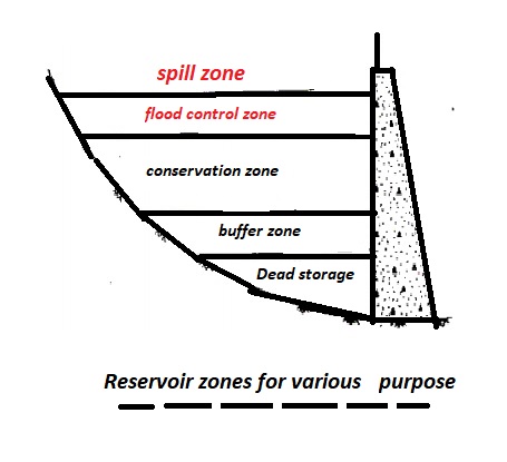

I have seen this typical pattern in all our dams and especially in Irrigation purpose dams like Chimmony Peechi etc. Here in peechi there is a different penstock for drinking water purpose alone, this level is much below the irrigation and hydro outlets. So our interest is basically for fixing the upper level for flood absorption i.e flood control zone.
Flood Control Zone
PIC5
PIC5
Picture (5)
The normal operation policy is to release as much as possible when the reservoir is in the spill zone, to release as much as possible without causing flood damages to downstream when the reservoir is in flood control zone, and to bring the reservoir to the top of the conservation zone at the earliest possible time. The release from the conservation zone is governed by the requirements of water for various purposes intended to be met by the stored water and the day-to-day releases may be adjusted based on the inflow anticipated and future requirements up to the end of operating horizons. When the amount of water is anticipated to be short compared to demand, releases may be curtailed. Limits of various zones may vary with time. So the time is the most important thing. As I said earlier if this inflow happened in June then the situation would have been normal.

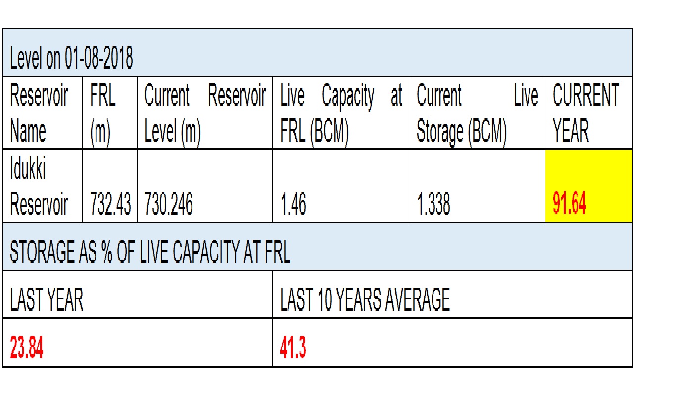

Let’s see what is the level of Idukki on 1st of august 2018.
DATATABLE
DATATABLE
As on august 1st 2018 the reservoir had 91.64% water compared to the last year average of 23.84 and last 10 year average of 41.3%. This data was taken from WRIS.
Here in 2018 we received the heaviest inflow in the month of august for the first time after the commissioning of idukki. That means our reservoir was supposed to have a cushion to meet the flood control zone. At least this could have been decided if we have some of the analytical tools so that the trend of inflow will decide the operational rule curve. If we look at the inflow vs average inflow during similar years, we can see that 2018 almost match with 1961 and 1971(picture 4). Moreover the inflow received during 2018 is almost the double of average inflow for these month(This is been shown in the picture 1 and it is For June - 226MCM, July- 438MCM, August - 376MCM). So what we could have done is that , to create flood cushion to meet double of average inflow for august month i.e 2*376=752 MCM. If the dam was lowered by 752MCM or half the live storage then we could have easily absorb 725 MCM of 1371 MCM (total inflow for august) and the impact in the periyar region could have been set to NULL. This would have made keralites to build 10 more idukki dams to protect kerala from floods.
